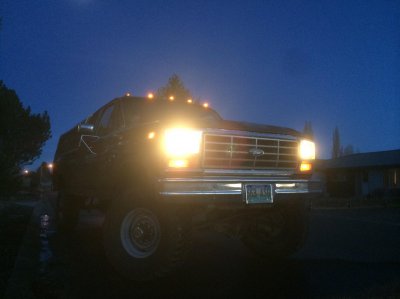

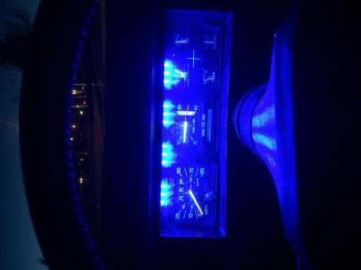

Hello all, after about 3 years of dreaming about it I finally picked up my first diesel. A 87 6.9. Honestly couldn't be happier! I'm also happy to be a part of this group, so I can bother you all with my problems! I already ordered some new glow plugs, and did a cool fix on the no dash light problem. I'm so excited to start my journey with this pickup. I see it going some great places in the next year. Be ready.

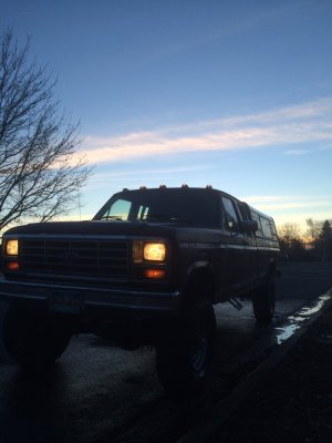

Nice looking truck. However, it is not an 87. With that body style and dash, it is and 83 - 86. 87 would be a bricknose, with the large flat nose and big headlights. This is a slantnose or bullnose.

nice truck, those dash lights would be too bright for me, but if you like them, thats all that matters.

Nice looking truck. Are those lights stick on or did you put a filter on the dash bulbs?
Welcome to the forum. As for the year of the truck compared to the front end. Just look at the drivers side door tag. these trucks can run many different years sheet metal. The may look like one year but actually are another year all together. As for Welman plugs.. Sad to say they are not very good. They are much better than champion or autolites but not near the quality of the Motorcraft Beru ZD( plugs. Depending on what type of controller for the glow plugs you might need the ZD1A spade type plugs. The ZD9 plugs are the bullet type.

Oops, I forgot we aren't so sure what year truck this is. The front clip is '86 and older. The type of glow plug controller would be a clue. The sticker in the door jamb will show the build date.

Welcome I would like to know how you did the lights also my eye are getting a little old the more light the better.
