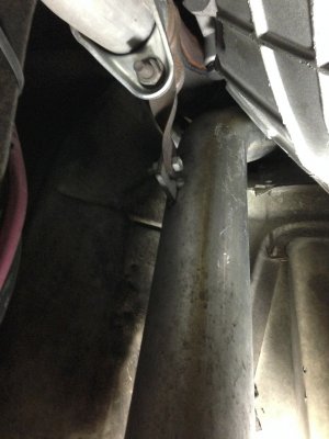

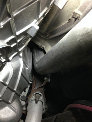

Here are photos of the exhaust on the down pipe side. No interference with the trans, engine, or firewall.

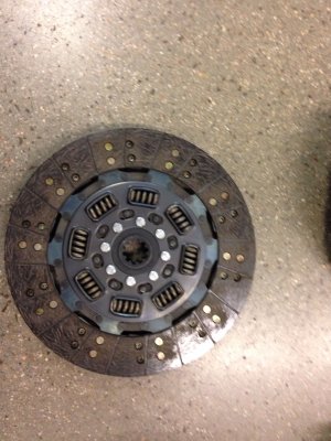

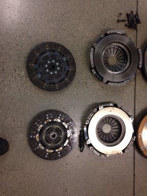

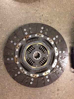

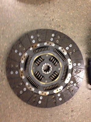

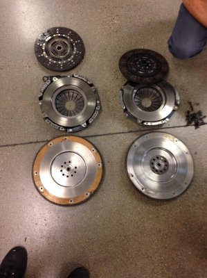

I FINALLY fixed this damn thing. 12 months, and several attempts, it was that damn clutch all along. I installed a LUK kit tonight and it's as quiet as it was with the DMF. Better late than never I suppose.

The LUK kit has 10 damping springs in the clutch hub, 4 large and 6 smaller. The Sachs kit has 8 smaller springs. From what I can tell, the LUK disc just has a better ability to soak up the pulses from the engine.
The Sachs kit was fine functionally. Engagement was smooth and easy, it just sounded like hell at idle. It was like that from the moment I installed it. I should have just stopped then and got it exchanged. I knew better. But I chased other problems, including a new trans before I got smart and went back to what started it.
