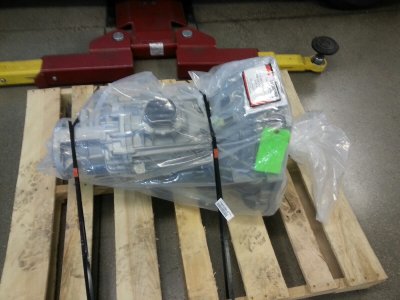

Looks like I have a little shop time ahead of me tomorrow...

Got it installed today. Started at 6AM, drove it to get a breakfast burrito at 9:00. Installation was straightforward, no issues. The good news? Vibration is gone, and I can use 2nd gear, both up and downshifting. The bad news? It still sounds like a coffee can full of gravel rolling down a hill at idle in neutral. That damn SMF clutch kit just flat sucks on my truck. Unless the noise is somehow coming from the transfer case, it's just caused by the clutch. I set the idle at 1000-1100 RPM to keep it from sounding so terrible. Surprisingly, it's very quiet at the high idle speed and nobody but me seems to notice. I'll start assembling the parts for a DMF clutch and eventually switch back. I drove it about 50 miles today, and noticed a fluid leak from the transfer case output, so I ran buy the dealership, and $30 later, I had a new seal in my hands. Got it installed in about 15 minutes, and all is well.
The transmission is a remanufactured unit from Zumbrota Bearing and Gear (www.zbag.com) and they were wonderful to deal with. The transmission arrived clean and bagged, strapped to a pallet as you can see in the photo. They included new shifter bushings (which I didn't need, mine were new 200 miles ago, attempting to chase the rollover noise from the SMF conversion) All said and done, the trans was $1600 shipped to me in Nevada. There was also a $500 core charge that should be refunded as soon as they get the old one back.
For now the truck is running fine, and shifting smoother than it ever has. I've had trouble with 2nd gear since I bought it, and after my fiasco with the SMF last february, I lost 2nd altogether. It's weird having 2nd right there when I need it- I've been used to driving "around" 2nd gear so I didn't have to grind in/out of it. I was really hoping a nice tight new trans would cure the awful rollover noise, but no such luck. At least it cured the other issues I had...
