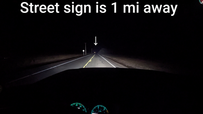

on my truck about 7 years ago i bought aussie headlights, shipped them over and then retrofitted 5x7 headlight housings with a 35w hid projector morimoto mini h1 7.0 in 4500k color.
since then I have added a set of diode dynamics ss3 max fog lights in amber and a set of dd ss3 sport driving pattern and a rigidhorse led light bar both toggled on with the high beams, so i have a incredible fogs and low beams and sun mimicry type high beams. plus everthing is sae compliant except for the light bar.

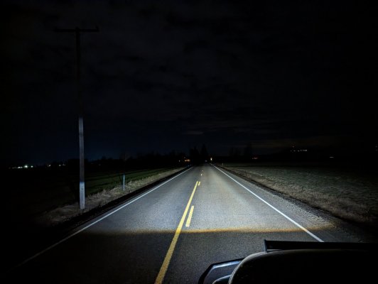

These are the 5700K Holley Retrobright lights. They are a white light, but seem softer than some other options. The road picture is low beams, and the picture of the truck with lights on is with the high beams on. I was standing about where I thought a truck in the opposite direction would be, but perhaps I am too far off to the right. The glare is little worse at car windshield height, and at low beams there isn’t hardly any glare.
I don’t know that these will be the last headlights that I install, I may look into HID projectors at some point, but these are most definitely a huge improvement.
The Aussie conversion was extremely straightforward. I doubt it even took me a half hour in total to install them.
11/10, would recommend. Pricy but if you drive in the dark quite a bit, they are absolutely worth it. High quality stuff for sure. And thanks to OBS Solutions, the Aussie kits aren’t terribly difficult to get ahold of. And with the Ranch Hand bumper on my truck, the lights are well protected.

I think those look pretty good. They do work well. My only complaint would be that they appear to be sealed beam lights. Anymore, I prefer to just replace a bulb instead of the entire light.
Nope. I found one more complaint. They are plastic lights. I prefer the non yellowing of glass. For the price, I hope they last a LOOOONG time before turning yellow.

Wow those lights blow my stock headlights out of the water, even with my relays and extra-bright bulbs. This really makes me want to attempt a DIY Aussie conversion
