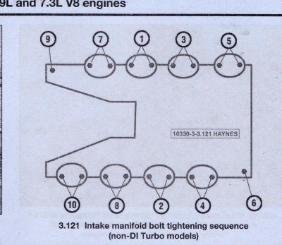

342
If you torque sequence the bolts down correctly on the intake, grade 8 bolts is sufficient.
