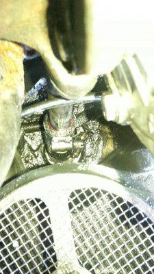

Its very possible the turbo is ok. Can't really say from this side of the computer. How did you cover the hole in the intake manifold where the CRD valve dumped to from the valley pan. Usually we run a CDR that sucks the blowby and runs it thru the turbo similar to how a EGR smog valve works on a gasser engine.

Heres some pictures of what im doing. To be onnest ive always worked on gas moters, this is my first diesel an my first turbo instal so everything has been learn as I go. An from what ive read an researched this is the best place for help in knowledge so I really appreciate all your guy's help! Ill try and take as many pictures as I can. I gues I should write what else ive got. From what I was told this moter was rebuilt an its got 180,000 miles on it.how ever im not sure on the extent of the rebuild. I ordered a set of reman injectors that are supose to work with a turbo for a really price out of a place called diesel injection out of Alabama. An my pump is turned up one flat already. I havnt gotten an exhaust temp guage yet I know ive gotta get on that.
