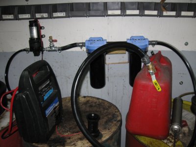

I started purcasing my WMO setup today. I bought 2 House Filtersetups, first will filter down to 20 Microns, the second down to 5. I bought a 12V pump that will pump it out of the 55 Gallon barrell that we dump our oil changes into. Once it it pumped out of there through the filters it goes into a holding tank on wheels with a hand pump so we can move it and store it in a 52 gallon L shaped tank with a 12V pump and fuel handle. It also has a meter on it to show how many gallons was pumped. That way I can keep track of the what gets pumped in to the truck, Diesel Jetta, and Diesel Rabbit Pickup (shop truck).

So now it is tomorrow and I got it installed in the shop and it works great!

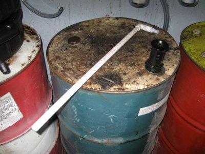

The PVC Pipe drops down in the 55 gallon barrell about 8 inches from the bottom, It can be pulled out easily to swap out the barrel.

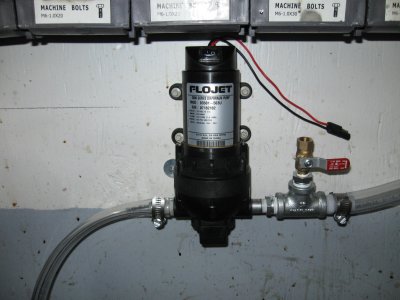

The pump is a Flo Jet 2.0 GPM 12V self priming pump. I picked up at Tractors Supply for $88.00
There is a small ball valve to open up the output of the pump to help it prime. I fired it up, saw the oil come into the pump, opened up the valve, saw the oil come through, and closed it again.

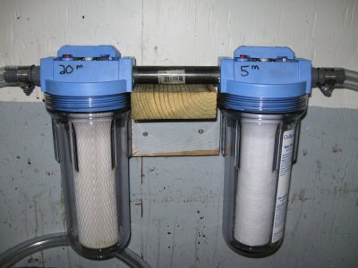

Then I used 2 Culligan Water filters, from TSC for $31.60 each. I got 20 MIcron filters for the first one, and 5 micron filters for the second one. About $3.00 each.

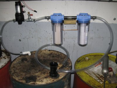

Total for everything with all of the misc pluming was $216.00 and It took about 4 minutes to filter 5 gallons.

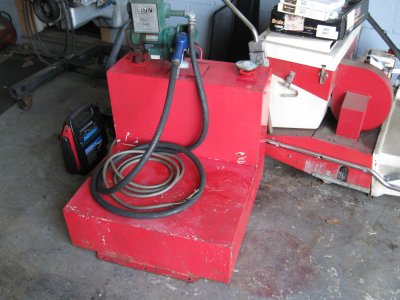

Then I dumped the oil in the 52 gallon transfer tank with a gas pump on it and will use that to fill the truck. So far so good! ;Sweet

looks good. i bought the same flow jet pump on a spray tank that i mounted on a wagon and use for a tranfer tank. imounted my filters about the same as you. i will move them to be directly over the top of my barrels so the oil spills back into the barrel when i change filters. joe

Nice, I would use a 1 micron filter for final filtration. It always depends where You get Your oil (You have Your own shop) but a filter that separates fuel from water would be a good choice too.
Hey Joe, I can see where the filter changes could get messy, I have run about 30 gallons so far and there is no change in flow, so I don't know how often I will have to change them, well see,...
I was wondering if you screened or prefiltered your WMO other than the 20 micron?
There is a screen that I use before we dump it in the 55 gallon barrell that catches all of the big stuff, but for the most part since Bob does all of the oil changes, he makes sure it is clean oil. If there is any contaminates, he dumps it in a "dirty" barrell and that wont get used.
Hey Zeek, Where I got the 20M and 5M filters there were no 1M filters, but after purchasing them I went to Godwin Hardware and they had the 1M filters for the same price as the 5M so I will probablly change to the 1M when the filters need to be changed. Maybee just add another filterset up and go from 20 to 5 to 1, might be overkill, but would be easy to do.

I used to run those pumps a lot in my business before I went to air powered pumps and you need to make sure that you don't have EPDM seal in the pump or it the seals will crack/ split and either suck air or leak oil in about a month... I use Viton seals on a 4300-501 FloJet and they work pretty good >> Make sure to have some kind of filter or trap before the pump because the diaphragms will get stuck open and make it sound like the filters are plugged up when there is actually a drop in pressure from trash in the pump.
