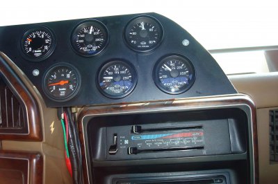

Nothing off the shelf or modifications will give you that torque reading. Sorry to say that too. These bottom ends can handle anything you can offer them but we in this idi world are limited in what can be done with these engines... Read what I have done to my engine. I still don't know what the torque and hp is but I wiil someday. I would not feel right posting that I feel like I have 300 hp at the rear wheels either. The fact is I have never posted any thought about this till now. I have seen other rigs making 202 hp with very little done to the engine other than a turbo. We do have some very nice hp numbers done a few years ago that were posted here. I do know my rig can easily run 85 mph in double overdrive with 3.55 gears and not strain at all. I have a gear vendors and with that my final drive is 1.96... Here is a dash picture showing these figures....
Gary that picture is sweet. I would love to have mine setup like that. I hate these 4.10s but at least I do have OD. I know on the interstate I could be running much more efficiently though.
