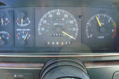

Nothing off the shelf or modifications will give you that torque reading. Sorry to say that too. These bottom ends can handle anything you can offer them but we in this idi world are limited in what can be done with these engines... Read what I have done to my engine. I still don't know what the torque and hp is but I wiil someday. I would not feel right posting that I feel like I have 300 hp at the rear wheels either. The fact is I have never posted any thought about this till now. I have seen other rigs making 202 hp with very little done to the engine other than a turbo. We do have some very nice hp numbers done a few years ago that were posted here. I do know my rig can easily run 85 mph in double overdrive with 3.55 gears and not strain at all. I have a gear vendors and with that my final drive is 1.96... Here is a dash picture showing these figures....

why is your oil pressure so low in that pic?
Its not that the oil pressure is low, its the sensor. The gauge will only show a pressure reading if the engine has above 7psi, if less it will drop out completly. Essentially it is an on/off kind of thing. It does not give a real time reading of the oil pressure.
Same thing with my van. It's just to say you have oil pressure, not how much.
