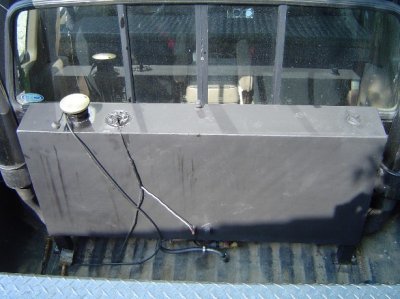

Hey Rob here's some pics of my system I mounted the diversion valve to part of the battery tray on our IDI about the only place for it with out making a braket to mount it to and I made a gauge holder for the temp and fuel level of my wvo tank

Nice work Aric! I imagine you get some pretty good heat on the tank from those stacks. Isn't it a sweet feeling to drive around on free fuel? Congrats man, you've got a nice looking/working install there.

Thanks Rob I just got back from TN. went 1200 miles and only had to buy 9 gals of diesel as for the heat from the stacks either its not as hot as we think or my temp gauge is faulty I have a piece of aluminum along the bottom of the tank so all the heat has to go up around the tank but the temps never went above 100 degrees in the tank according to my gauge which is fine because I figure my heated line gets it up the rest of the way but I'm afraid when it gets colder it won't heat it enough to be liquid I just used a water temp gauge and sender does anybody know if theres a reason that wouldn't work in oil
