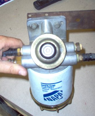

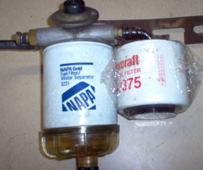

Here are a couple of pics of the filter and head, compared to a standard filter. You are probablly wanting something bigger but it is an option for you.

Is that setup a standard Racor head with a NAPA filter. I guess my question is, does NAPA sell replacement cartridges for the Racor system?

Thanks Darrin. As you say, It's still bigger than the stock one. Thanks for all the input and ideas guys. Lots of good ones in here. Once I get my 'refinery' totally setup i'll start a thread in the alt fuels section to let you guys know how it turns out.
