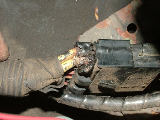

And here is that same connector after melting. Luckily only the yellow glow plug cables were affected on this one. I simply cut them off and re-routed the power to the glow plug controller.
