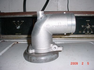

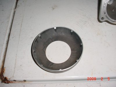

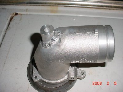

Ford part# 5C3Z9Y432AA
Here are few pics. Russ did all the work to the top hat elbow.;Sweet

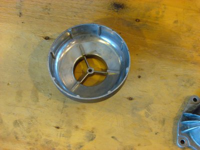

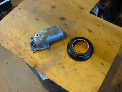

russ if you are on where did you get that bottom piece? are you just sandwitching it between the manifold and the elbow?
typ4
Dec 24, 2005
9,131
1,431
Newberg,OR
Yes, It is a propane adapter hat from Impco for a model 125 mixer. I bore the center out and shorten it also to clear the turbo, weld a bung in the top of the elbow and drill it for a 3/8 rod to clamp it all down.
