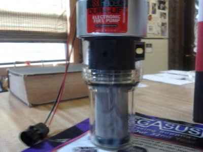

My electric pump arived today.
Here's what I know I need so far and I'm picking up tommorw.
Chevy block off plate from a chevy 454. A inline 5amp fuse
A 4pin relay( not sure what exatly to get tho) I also realize I need to make a bracket.
Have to pick up a few 90 degree bends with barbed ends. And a few feet of 3/8s fuel line.
Is there anything else I'm missing?

ok heres what i was able to pcik up today.
i got a role of wire conduit to cover everything when im done.
a inline fuse holder rated for up to 30 amps and a 5amp fue to put it. along with a box of 5 amps fuses to keep in the truck.
and a 4 pin relay. made by bwd. going to return it if napa has the bosh one.
my local autozone did not carry the block off plate and advanced auto wasnt smart enough to find it on there shelfs.
so im going to go intown to hopefully get a diffrent relay. block off plate. and about 5 foot of 3/8s fuel line.

I think I'm over complicating this...
Ok the relay has 4 pins(duh) I take a male connector to connect to the outlet of the pump and that goes to one pin on the relay.
Then I take a ground wire and put it to another pin on the relay.
Then a constant power with the inline 5 amp fuse to another pin.
Then finally the last pin goes to fsv am I right here?
Then it's just as simple as pulling mechanical pump off putting block of plate on and attaching fuel lines.
I believe there are several ways to hook up the relay. I went through past posts and found five variations, from the four spade connectors.
I THINK this is the way I did it, and was approved by Calvin. The terminals on the relay are numbered, 30, 85, 86, 87.
30--to the battery, with an inline fuse.
85--to ground
86--to ignition (wired in to the FSS on the IP)
87--to the fuel pump
That being said, I'll go out and check on the truck itself, after I have a bit more coffee.
ON EDIT
Disregard what I said above. I looked at the relay itself, and will correct things.
30--to groung
85--to fuel pump
86--to FSS
87--to battery.
As I said, there are a number of ways to wire these things, and most of them seem to work. You just have to pair the right terminals together.
