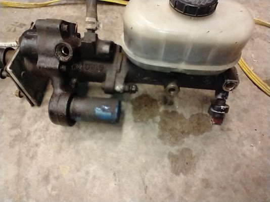

Thanks for the reply turned out to be the vacuum booster. So I've been looking for a good reason to change over to hydroboost. I have the booster and the power steering pump on my 96 F superduty parts truck and I was really surprised to see that they both will interchange on this 86, at least it definitely looks good like it'll fit.
Question I would ask is if I should use the master cylinder that is on the hydroboost or should I stay with my old master cylinder? The 96 F superduty parts truck that I got the hydro boost from is disc brakes all the way around . the 86 is disc in the front drum in the back.

I used my original 1-1/8” master cylinder with the hydro boost conversion, and I did not modify the pedal arm. I’m very happy with how it works. I elongated the bolt holes in the MC and made a simple bushing to keep it centered in the hydro booster.
I didn’t even open up the brake lines so I didn’t even have to bleed them again. Took about 2 hours to swap over to the HB for me.
Is that the 92 that you're working on? I see it has the aluminum master cylinder mine is 86 and has the cast iron master cylinder. I would hope to get by with only two hours labor as you did but I already have that much in getting the old parts from donor truck lol. I don't yet see any reason to alter the foot pedal so I'm hoping I don't have to get into that.

Yes, it's the 92. I would think you could modify the cast iron master cylinder similarly. If you go with the larger 1-5/16" master cylinder, I would modify the pedal. Its all about keeping the same volume of fluid pushed out for the same amount of pedal travel.
That 2 hours didn't include the time I spent rebuilding the Hydro Boost, or shopping for parts, but the actual conversion for me was pretty straight forward.
My master cylinder the cast iron one bolted right up the depths for the rod is the same on both cylinders. Sure hope I don't have to get into that pedal travel adjustment I don't have a clue how that works. Guess I'm just gonna hook it up see how it works.
I'm changing my power steering gearbox at the same time. Got that power steering pump out of the way can access them hoses is a little easier, gotta be done anyhow. Thanks for the help.

This is what I did with my pedal for hydro, just drilled a hold for a 9/16 bolt and think was 3/4 an inch higher. Had someone weld it and drilled a hole for the retaining clip, its worked fine like this.
