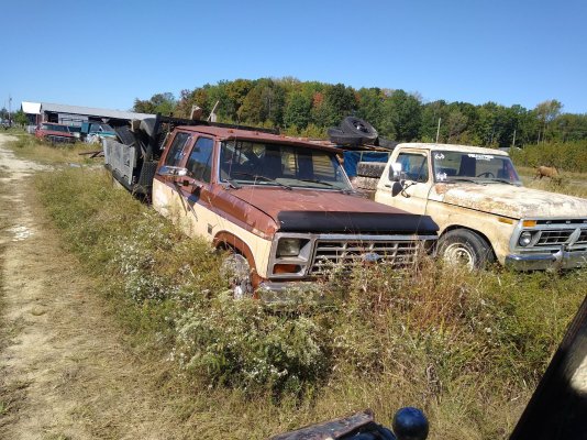

Here's a picture of the 86 sitting in the weeds sat there for almost eight years just couldn't get to it
