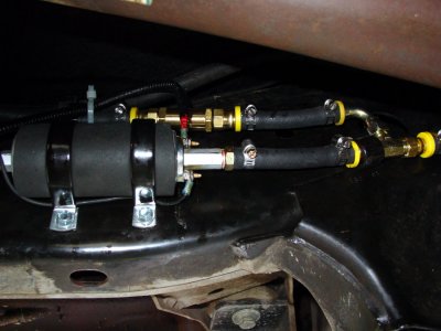

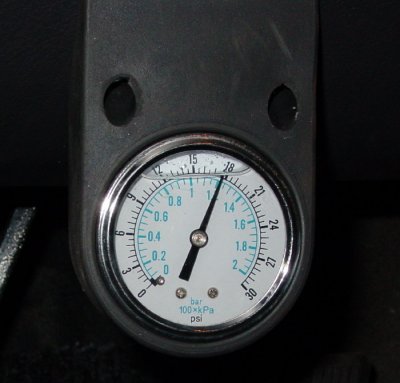

"How many lift pumps have you gone through"?
It only needed to take one lp failure for me with approx 35,000 miles on the ticker. It took out the VP-44 with it.
I now run a solid 15-18 psi at idle or WOT.

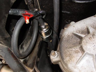

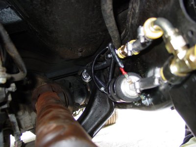

Crazy Horse
Feb 8, 2004
9
Cherokee County,SC
Here's another shot, and prefilter that is used in addtion to the factory filter housing.
