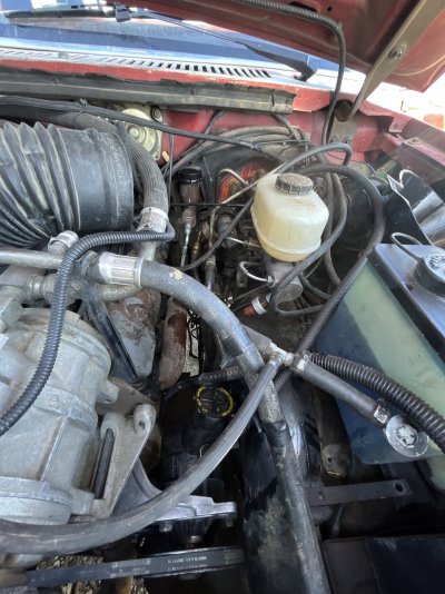

Update: best 55$ I’ve spent in a while hydro boost grabs!
You got it off a Superduty correct? What year?
Mine is a '90 F350. What all years are the same brake set-up? IE: Your '86 same as my '90?
And what years of Superduty do I need to start being on the look out for, or what other rigs hydroboost will work on my '90?
What it comes down to is I need to get with it & find a hydroboost set up that will work on my '90.....& get r did!!!

I got it of a 90’ f superduty I presume all f superdutys will work, it was all plug and play minus the pedal mod
For the 250 and 350’s the brake setup is slightly from 86 to 90 they have different master cylinders and the 90 will have rear abs
I’m aware that people have used other models for hydroboost but then they run into issues with pressure, firewall fitment, and booster rod geometry. In my opinion that’s would be too much effort for this swap so personally it’s f-superduty or nothing
