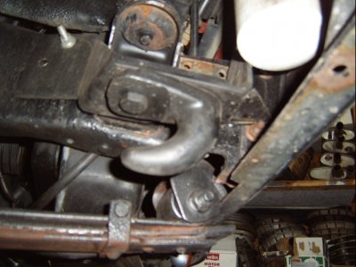

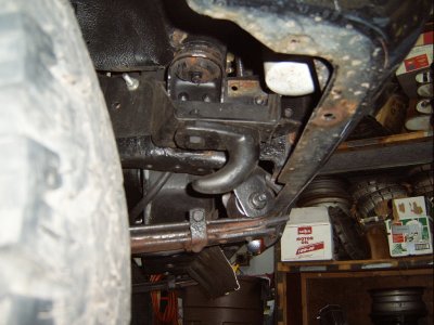

My F350 has this underneath, very heavy duty and it's well built.

Thanks for the pics BigRigTech. They bring to mind that a 2" receiver hitch would be put to good use on the front, not only for spotting and tow duty, but also if used with a step would eliminate the need for me to grow another 10-12" legs or get a step stool when servicing the engine. Now to find a front receiver hitch mount, hopefully at the wrecking yard.
