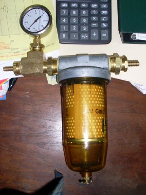

1,442
here's my goldenrod filter housing with brass fittings. brass fittings cost more than the filter itself.-cuss-cuss-cuss-cuss-cuss
Good job, great picture!
I guess the gauge is installed after the filter in the line, so it will show any drop of pressure due to a filter element clogged. Is that right?

burt-
i put it in before the filter to look for rise in pressure. I have the goldenrod and two other filters the fuel is pushed through. To me, the rise in pressure is more important to watch for.
