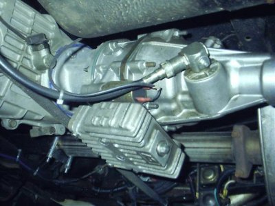

Let me also add that I now have both our trucks equipped with a Gear Vendors overdrive unit.
The Moose truck installation looks like the picture below on the left and is mounted as part of the BW 1345 transfer case.
The Lady Moose installation looks like the picture on the right, and is a divorced installation which replaces the carrier bearing in the two piece drive shaft of this crew cab.
The Moose Truck has a 3.54 rear axle ratio, and T-19 4 speed transmission which at 55 MPH does 1400 rpm in overdrive.
The Lady Moose, which has a 4.10 rear axle ratio and a ZF transmission (which already has overdrive) does 55MPH at 1500 RPM.
So, you can see that if you have a 4.10 and ZF, the double overdrive is much like having a two speed rear which switches between 4.10 and 3.54. Very excellent for towing, as you have 9 usable forward gears. If you have a 3.54 and a ZF, and then added a GV unit, your RPM's in double overdrive would probably be too low, as you would be under the torque peak of the IDI, but as GV often points out, the planetary gears in the GV unit are stronger than the 5th gear used in the ZF, so you could stay in 4th and just run the OD unit. With a 4 speed T-19, which has a gaping hole between 3rd and 4th, as well as no OD, the GV unit is a perfect match. The US Gear and Ranger overdrives should offer similar performance metrics.
