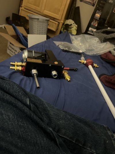

These fass Instructions are kicking my ass but I just figured out the line from the fass is 3/8 not 1/2” like I thought which makes life really easy because I’ll be able to use the fitting from russes hard line delete *phew* buying fittings online suck
