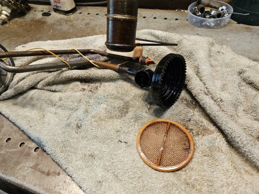

One time I had to get replacement gasket for a hammer mill. At Ace Hardware they have sheets of red rubber industrial gasket material. Looks exactly the same as these tank seals but comes in square sheets. I too am having to rework my sending unit. My pickup/return pipes look like the out of yours. I know about ospho because we use it in marine environment to clean rusty steel stuff like chains etc.

Just doing this on my 93...
Front sender was full of fuel, split length wise at the metal arm.
So' fun fact, the tank is metallic not plastic On this one...
60 k and the goofy poppet valve is mia.
Showerhead still supple.

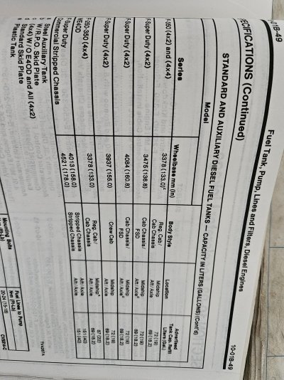

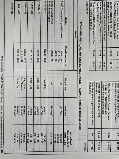

I ran em dry then filled to the necks and got
19 front ( the one missing the poppet valve in the showerhead
and
18 in the rear ( gunna pull the sender tomorrow and edit this)
Hopefully I will get 3 more gallons of usable fuel fixing the showerheads...
Sounds like we may have a new tech 101 in the making here... ;Sweet
Eta
Fsm states extra cab
19 front
18.2 rear
