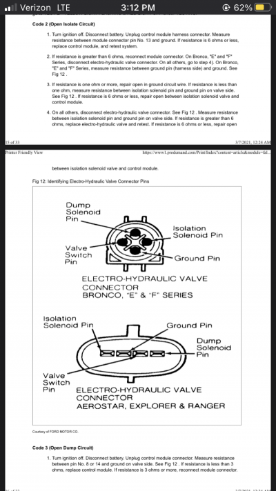

Got the error code from the RABS unit and it’s fault #2 - Open Isolate Circuit. I’ve found a rabs diagnostic page (attached) from ford and believe the ground on the rabs unit harness to be bad.
Can I just cut the ground wire at the harness and ground it to the frame? If it doesn’t work can always splice it back but would like to save the hassle.
Grounding has given me some confusion in the past so not sure if this is a valid way to ground the rabs unit or if it needs to be grounded further upstream from where the wire originates

The ground wire is either between the battery and the core support on the left, or on the right. Ive seen it in both places. On my 1990 it is behind thr drivers battery and the connector likes to come apart at times.

Yahtzee fixed the light haha. Yep @Nero was spot on it was the plain black wire on the passenger side between battery and fender.
Was able to check continuity between candidate wires at the firewall and at the RABS harness. What’s odd is the wire switches from black/white tracer to plain black somewhere in the engine compartment. The harness doesn’t appear to be tampered with but was open short regardless. Oh well.
Just snipped it and bolted it to firewall.
