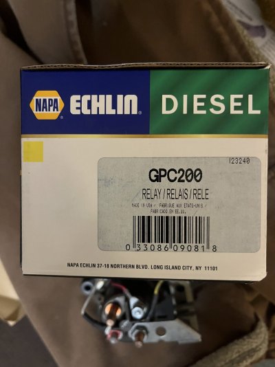

I then replace the controller (Napa-Echlin) but the problem persists. The relay only clicks.

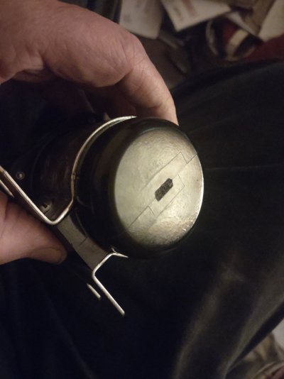

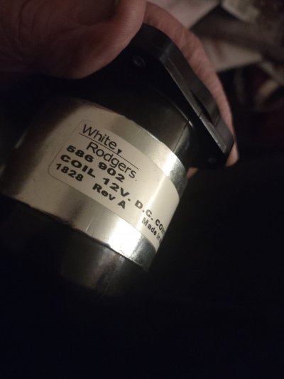

I believe Emerson Electric is now making them. I understand they were designed for large industrial HVAC controllers. They run about $100 to $200 /ea ( about 10x the cost of the auto parts store parts price. ). For me, well worth it as if these things fail, there are substantial cascade failure costs and lost time in goose chases
That is what I am now using. I have had absolutely no further issues with it. It is not mechanically the same size as the original relay ( It is larger and heavier. ), so you may have to rearrange some mountings to make it fit. There are many glow plug woes and cures posted in the IDI forum here. Search for them. Some of them are mine. Several years old now.
Few things are more frustrating than finicky machines when you can't trust a supposedly new part to be good.

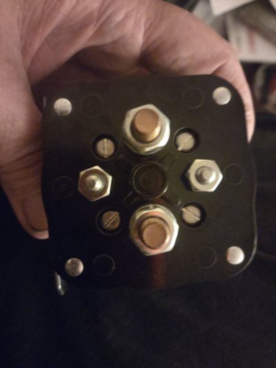

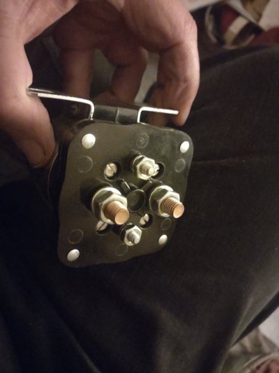

Ground goes the button.
The two smaller terminals on the contactor are the coil.
One terminal is connected to the ignition key circuit that is powered ON when the key is in RUN. The other terminal is brought to ground through your pushbutton to complete the circuit and energize the coil.
The coil circuit for this contactor only draws 1/2 amp or so. So you don't have to use really heavy wire or finicky grounds. My ground is wired to where I had mounted my contactor to the engine block using the same holes the original glow plug control module mounted to.
I've had the same experience with how rugged ( and hermetically sealed ) the White-Rodgers contactor is and why I back Wes ( CDD ) on his products. I have built those contactors in to many things. Including things controlling microwave ovens, ranges, household HVAC, and air compressors. Mostly for safety lockouts, as I never know if a "Solid State Relay" block will fail ON if lightning strikes a power line, and I am not willing to chance an appliance failing ON because lightning struck a nearby power line. I want an old-school air-gap, not a reverse-biased PN junction, between Edison and my expensive and fire-prone machinery.
