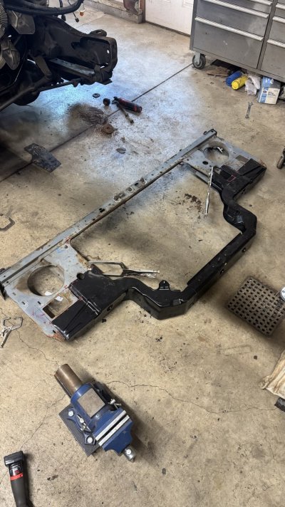

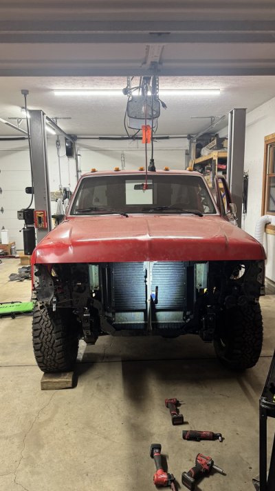

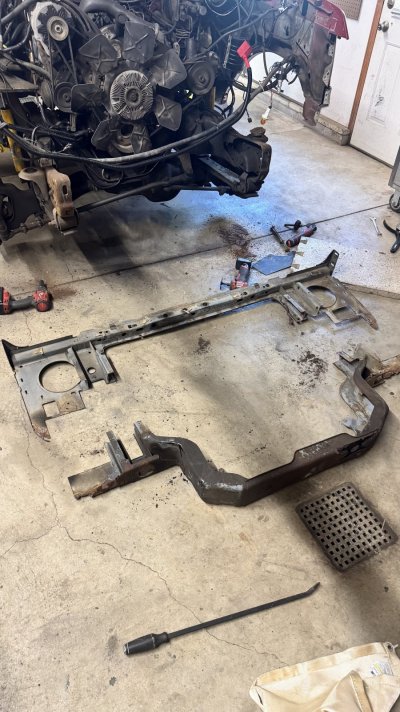

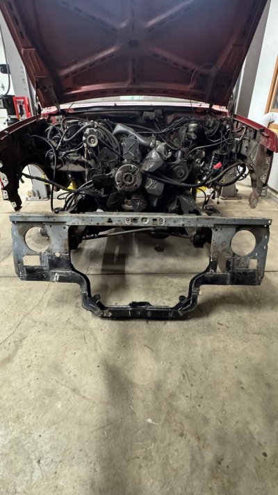

Theoretically, if I were to buy a diesel core support for a 92-97 truck, would I be able to cut off the bottom hoop and the side mounting points and weld it onto my core support? I know the way the fenders mount is different but from what I’ve seen on the forums it looks like the bottom hoop and side mounting points are the same?
Both mounts are gone on mine as well as a good section of the bottom hoop
My truck has factory ac (although it doesn’t work at the moment) but I would like

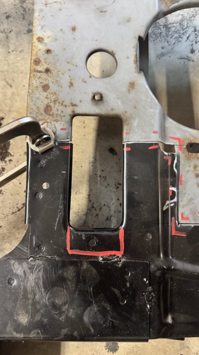

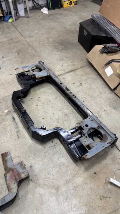

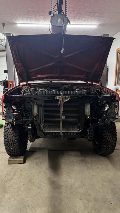

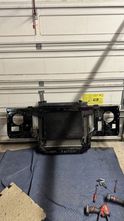

Spent a few days mating the top half of my original core support with the bottom half of one for a 92-97 diesel (BDY-FO1225249 - $260 from summit) and it worked.
Only slight differences is I had to expand the hole for the intake tube and I had to just slightly shave down the studs that the radiator sits on. The new core support is slightly narrower on the ends, but its just sheet metal so I made a couple pieces to make the transition less noticeable.
I had some gaps to fill… oops. But I made some plates to go on the back and strengthen it. I used the radiator mounting brackets to keep the spacing right between the two halves while cutting it and welding it.
I welded all the seams on the new part of it to keep moisture out as well, then got it sandblasted and powdercoated (for $80!!! Can’t beat that!)
Everything lines up perfectly. I’m in the process of getting my body lines evened out now, but its looking like its gonna work.
