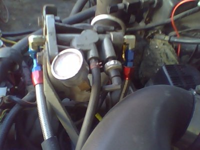

That is oficially called an ORB thread . Were you wanting to do something like this?

Well I hate to blow the covers off a good poject before it's even under way, but I'm planning on offering a kit to replace the filter head to IP hard line with a fancy show quality stainless braided hose and colorfull XRP fittings. Just a little something to snaz up the engine compartment and solve the problem that people with Hypermax Intercoolers have once they install one... that is, the inability to change fuel filters without taking something apart. A perfect accessory for a Moose Pump. I've got all the pieces I need except for this one. My guy at American Speed is trying to find me what I need, which is this ORB (thanks for the acronym explaination ;Sweet ) 5 to AN6 deal.

Well I'm not a current Moopse pump owner but I would be interested in that particular line since it appears Goldies has developed a fuel leak and that line appears to be the culprit at the IP connection.;Sweet
