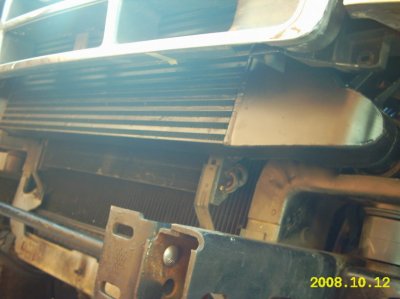

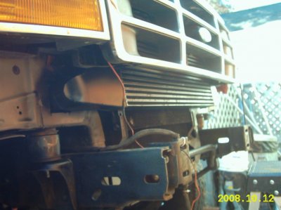

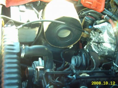

I wanted to post a video but I was alone so I'll post some pics and the video if possible. I need to get the power steering to work right and the front bumper ON and I'm waiting for the air filter pipes but everything else is ON. The banks IC fits perfect I didn't even had to cut the grill.

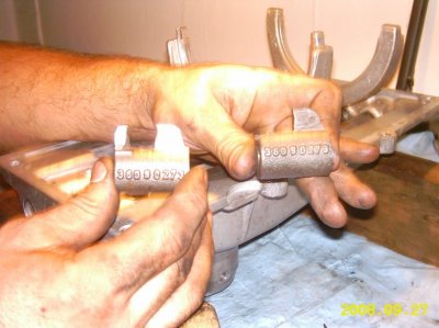

I'm happy the getrag will shift through all the gears after I rebuild it, it was My first one and seems to have worked out well. What I like most is that I can rebuild it Myself instead of a shop charging Me premium for it.

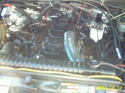

Engine sounds well as before I have to figure something with the PS pump on the cummins it was perfect before the swap and now I can't get it to move the fluid so something could be wrong there. Btw is there a problem if I put Lucas PS fluid on a dry pump and then some of the regular ps fluid?
Tach reads but I think it is off, I couldn't tell since I didn't drive it out of the driveway just tested it where it was since I didn't want to move it around with out power steering assist.

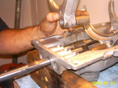

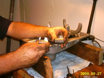

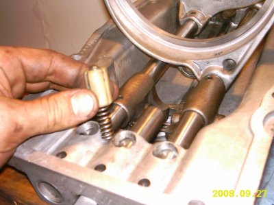

Here are some pics of the engine bay and some of the tranny rebuild when I was almost done with the shifter cover. I'll get the video when I get this ps pump right. The same gear drives the vacuum pump so I don't get why would it not drive the ps pump :confused:.
