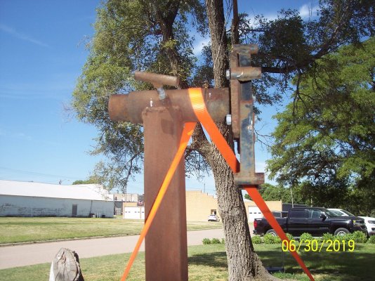

Yes it certainly is hard to get stock. Here's something to keep in mind if you do have someone build you a stand (or if you make it your self). EVERY home made stand that I've seen has had the head (the part that holds the rotating part that bolts to your engine) sitting level with nothing on it. That means that when you get any weight at all on the stand, the engine will be drooping down. I know that it may just be my pet peeve, but I HATE that. Factory built engine stands are built so that the head slope upward at the front when there's no weight on the stand so that the engine will be close to level when it's all assembled. I also won't use an engine stand that hes a "U" shape to the bottom part of it. It gets in the way and I stumble into it. I also like to rest my foot on the center beam while torquing head and main bolts. That keeps it from rolling toward you as you're working. My stand is a four caster model, but it has an "H" pattern to the bottom. I actually bought mine form Sam's Club back in the late 1990"s. It's rated at 1200 lbs and works great for an IDI engine. Here's a couple of pictures of the type of home made stand that I hate. This one was free and it went on to the next guy for free too. You can't see the entire bottom part of my stand, but you can get the idea. Am I picky about my engine stands? You betcha, but I also want to be comfortable when I'm using it.

I looked at all the stands on fleabay and most seemed to be the exact same chinesium, sold under different labels. Similar story on Amazon but less (fake) choices. Only a couple of them on fleabay had the unloaded-angle-up feature that you mentioned. It sure makes sense. Right now I have an IDI on a hand-me-down stand and we could see right away that it was going to bend if we didn't brace it. I used to have access to take-off OEM rear wheel bearing and hub assemblies from fwd 3/4 ton delivery vans like the Ram ProMaster van. I had to leave that all behind when we escaped from yurrup a few years ago. That would have been a perfect part to build an engine stand on ... spin with big wheel bearings. I welded up kids' toys for the yard with those bearings, hubs, spindles.

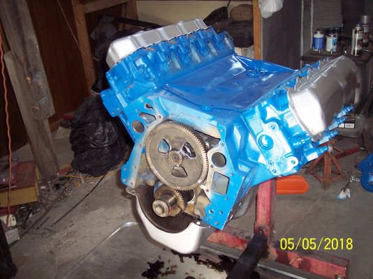

I built this guy a number years ago after deforming a Harbor Fright engine stand with a Ford Flathead V8. Couple of hours with the chop saw and welder, and it works wonderfully. It has held up a bunch of engine projects, including a 300 inline 6, 327 Packard Straight 8 (long, heavy motor with a CG way, way out there), a 430 MEL (850+ lbs), a 315 Dodge Hemi, multiple Ford FE's, and currently my 6.9 IDI. One of the casters is giving out, but that is an easy replacement.
