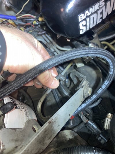

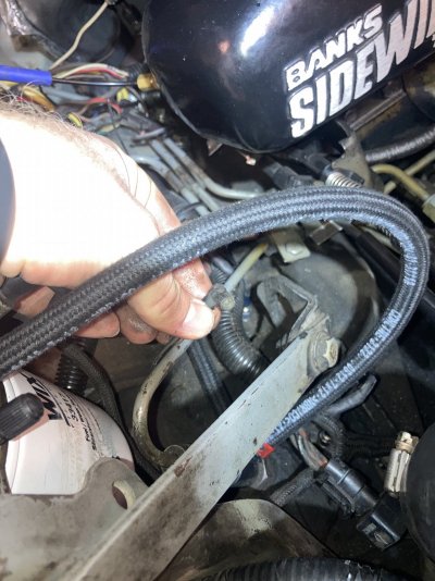

I was wondering if anyone knew where the hell thing this was supposed to be plugged. Its on a harness that heads from the IP towards the passenger side. Found that plug kinda sitting on the passenger valve cover.

That's for your Water in Fuel light. You may not have a sender on the bottom of your fuel filter.
