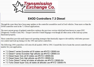

I did some further testing and I am pretty sure the computer is bad. I found one on parts geek for $101 its remanufactured, not sure if that's good or not. its made by standard motor products. I could only find one for a 1989 and it doesn't specify the motor or tranny. it doesn't seem to be a common part anymore. my question is, does this one seem to be a good one to buy.

Reman is the only way to get a TCM. They haven't been available new for years.
Have you tried Ford? It will cost a bit more through a dealer, but it should come with the latest reflash (94 program).
94 shift schedule doesn't suck as bad as the earlier programs.

I did try ford and they said it is discontinued. I didn't ask for a 94 computer, my truck is a 91. should I try to find one for a 94 year truck?

If you ask for a 94 computer, you'll probably end up with a powerstroke pcm which has the tcm built in.
Specify early 94 if you can.

make sure 100% that power is getting to the solenoids.did you inspect the pack plug?
doesn't suck at all imho.there isn't a thing id change personally.
