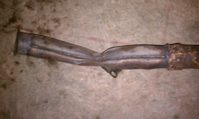

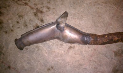

So...I was searching and only found DYoungs cobbled down pipe and mention of one I can purchase. I have a couple of questions..
Does anyone have pictures of anything commercially available or any fellow oil burners work?
What good does it do to come right off the turbo with 3.5 inch if the turbo exhaust flange is quite smaller?
Why did they call themselves engineers? The following two pics are embarrassing ;Really

Yeah.... That does look terrible but look at it this way... No matter what you did you didn't increase the flow thru that squished banana down pipe. Towcat did a great write up of how he "fixed" these terrible factory down pipes. Never saw much more after that posting..:dunno

The reason for the crushed downpipe was so that Ford could easily make it clear the firewall. 3" is tight even after cutting the firewall away and peeling it back some. Brad may be right that the 4" just won't fit.
