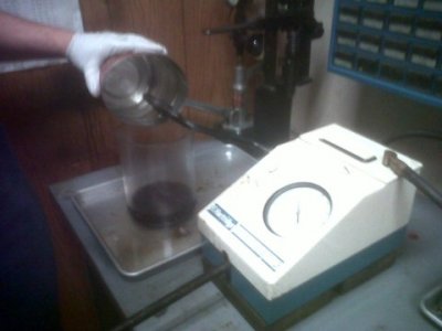

Update over here: Boss at the inj shop STILL didn't want to pop the BBs I bought there. :dunno
After some badgering, she did say she was going on vacation, but her guys would pop test if I bought them lunch. ;Sweet
I did, and was allowed to watch the testing. All had a nice pattern, popping within 50 psi of the 130 bar mark.
:D
