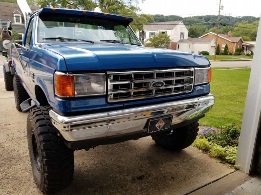

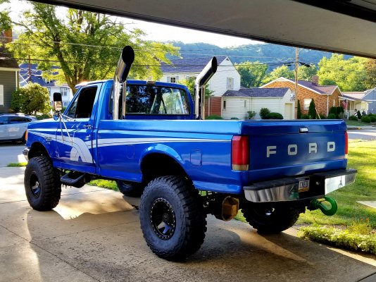

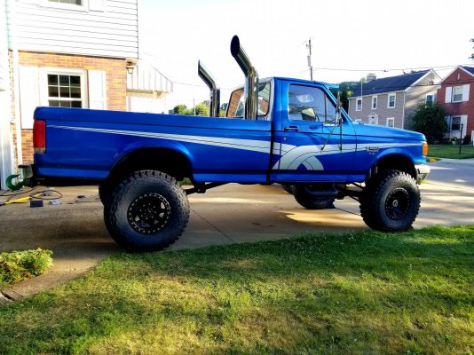

I know it's been a LONG time since I posted.....but one thing led to another.....and I ended up spending A TON more money than I planned. I basically rebuilt the entire suspension with far superior parts. Decided to go with the 37's.....and with all the extra work I did.....it drives way better than it did before, and it even has more low end get up and go, as I upgraded the gears, and went with 4.10's from the 3.55's it originally had. I considered 4.30's.....but ultimately I think I made the right decision. The truck cruises down the highway very nicely, at a decent RPM.....and has PLENTY of grunt at low speeds. She is still a work in progress, but she is coming along nicely. Let me know what you guys think so far.

Big clean truck, the 37s dont look like 37s on it. Details on the wheels?
Thanks man, I've been working ******* it. I could have easily cleared 40's, but I wanted room for articulation.....and I actually feel like the 37's give it a really nice look. Anyway, the wheels are Method 108 Bead Locks in Matte Black. They are 17"X9" with a -44 offset, backspace is 3.50. I really like the look they give it.....not to much poke, and not to little. They are a real bead lock on the front side, and a bead grip on the back. Twenty four 3/8" grade eight bolts for hardware. I balanced them with 16oz of Counteract Balance Beads per tire. Unlike airsoft beads, or BB's.....they are TINY polished glass beads, that actually hold a static charge, and DO NOT hold moisture, or clump together. I can drive down the highway at 70+ MPH and the wheel is GLASS smooth. No vibration felt in the wheel at any RPM or speed, other than normal IDI motor vibration LOL. I could not be happier with them.
