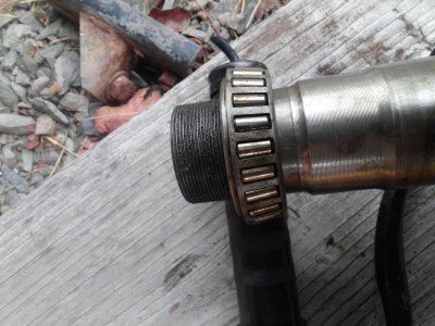

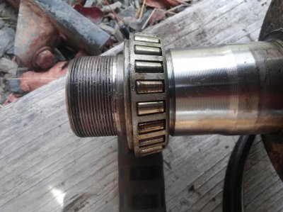

Ok, sooo... I test fit my old bearings on the new spindles to see if they fit any tighter. They fit totally different. Now I'm not sure how the outer bearing is suppose to ride on the spindle. On one set they sit right near the end of the threads. On the other set they sit deeper and leave a gap between the bearing and threads. I'm thinking the set that sit closer to the threads are correct because the nut has to snug up behind it and with the gap on the other set the nut wouldn't even come close. But I'm not sure if the other set just doesn't sit as deep because the bearing spun and wore a ridge that it won't pass over...Ok, enough rambling. Which one is correct in these pictures ? Both look weird to me.

I know it looks like the bearing had been sitting deeper on the first pic but it actually has a clear wear line from the bearing right under it and there is a slight ridge which may have been from wear that prevents it from sliding on deeper. Both sets are identical to their pair , so one set sits deeper and the other set have the ridge and sit right after the threads..

After looking at it closer it's obvious that the first picture is correct. The bearings sat in the same spot on the other spindles despite being able to slip on further ( Wear marks in same location) . So either the bearing is just worn or the spindles are worn and allowing it to sit deeper. Won't know until I check with quality bearings. I shouldn't have even test fit my old ones , just confused myself and wasted time.

Keep in mind it is not the spindle that limits position of that bearing, but the hub with the outer race. The outer bearing is free-floating, it sits where it wants to sit based on where the hub's outer race puts it. So even if it can go deeper down the spindle, it likely won't cause the wheel hub won't let it. Put your hubs on with good bearings, I think you'll find out all your worries were for nigh :D
