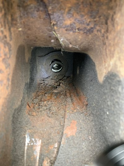

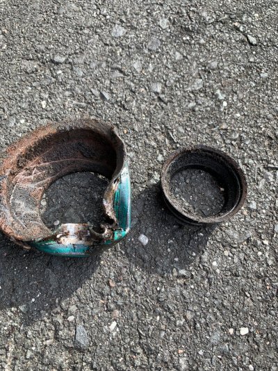

Little set back lol … Drivers side axle seal broke
I also think I need to pull the front diff, I’m pretty sure it’s leaking, got a pile of gunk all caked on the rock guard, and I’ve seen drips that smell like gear oil.
I can put my pinky in the fill hole and not feel oil, so it had to go somewhere….
So I guess the answer to how in depth do I go, is all the way!!! Lol

Full send. Love to hate it, but peace of mind sure is nice. Great thing about pulling the diff is, if you dont replace any of the diff bearings you don't have to worry about resetting lash and all that.
Right its the only saving grace actually, Gonna do both seals while its out as well, shouldnt be a horrible job... I hope

I did the diff seals on my d60 king pin, pretty sure the diff chunks are same or similar. But the axle shaft seals are the same way. Press from the inside out. Reused my bearings/shims, play was still the same.
