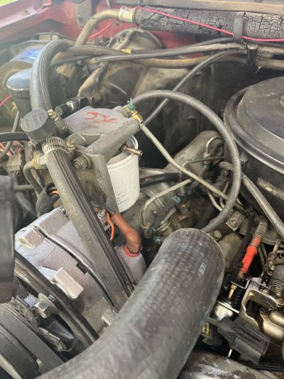

I think the hose vibrating causes it to look like it’s moving a lot. The video is short but it looks like the hose is vibrating and not so much the filter head assembly. When you watch the hose coming off the rear of the filter head, it’s not moving much.
4,362
4,993
Looks like its missing the bracket that bolts to the intake manifold.
The Kodiak is on to something there. Does it have the bracket that braces the filter head to the intake? And yeah the hose is wiggling, but the filter is too. Just bring it over to my house so I can mess with it!
Go ahead lol I’m trying to get my big block running not toy with the 6.9 atm

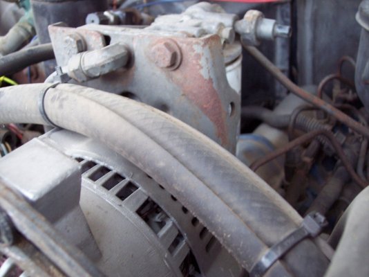

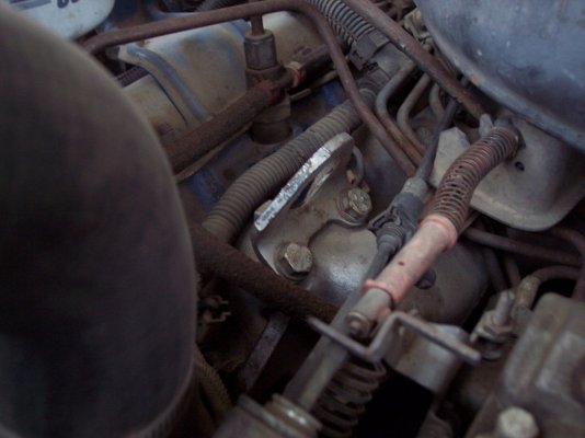

They all didn't have that brace. I think that, generally, the 6.9s didn't have it. This may be the reason why they started putting the brace on. For those who don't know, this brace runs from the front of the filter head bracket to the front lift eye that's on the intake. I obviously don't have it on my truck, but you can see where it was originally. My lift eye is the wrong one for that brace too.
