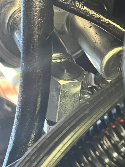

On the way back hauling a 600$ bull i bought I smelled diesel bad and saw my gauge drop so I pulled into the gas station and was greeted to this mind you it was 5x bigger by the time it was done leaking
Thought it would be the 4” rubber line on the inlet but no my 6 month old 3k mile Delhi pump cracked
I would like to know why this happened to see if it was just a defective pump or external factors where at play to prevent this form happening again

Got my pump out and not only was it cracked the hardline is spraying diesel out of it now
How can both a fuel pump crack and the hardline break at the same time I’m so lost

Didn't hit something recently that could have weakened it? Perhaps it took a while to actually break open.

Where could that much vibration come from?
No it didn’t hit anything to my knowledge but that is the theory I’m most leaning on
Where can I even buy a new line besides Russ’ hard line delete kit?
Are you wanting to put another mechanical? If not, just cut the line in a good place and put on a compression fitting and adapt it to a 3/8" hose barb, and put in a patch hose between the newly installed hose barb and the other line with a hose barb already.
