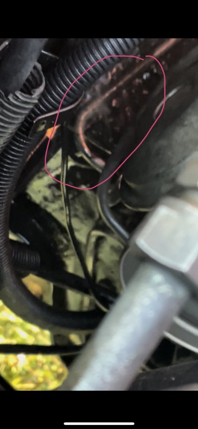

Got my pump out and not only was it cracked the hardline is spraying diesel out of it now
How can both a fuel pump crack and the hardline break at the same time I’m so lost
Did the bull cream your truck? But yeah that's pretty heavy duty vibration, if it's vibration. Was the nut cross threaded, maybe?

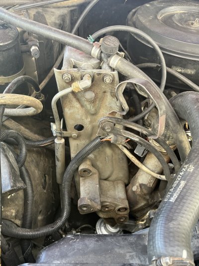

Is this abnormal vibration?

Another thing to check would be the bolts that hold the bracket that your alternator pivots on. You may have to remove the vacuum pump to get to all three bolts. If those aren't tight, that may allow the filter head mounting bracket to move like that.
14,976
14,078
One more thing to check is to see if that bracket itself is cracked. I haven't seen that happen, but I suppose that it could.

All 4 bolts where tight no cracks as far as I can tell

It sure looks like it's wiggling in the video. I watched mine this morning when I started it up and it didn't look like yours, as far as wiggle goes. The filter head isn't loose?
