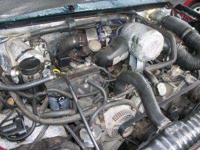

i use (as seen in pic below) Napa Filter Head #4019 & Penray Need Release Coolant Filter #NF2088
that's the real cavitation prevention.;Sweet
I went the same route but went with IH parts. Went to a parts dealer and they ordered me up an IH filter head and some fleetguard precharged filters. I put brass valves on it so I can change the filter without much loss, mounted in the same location.

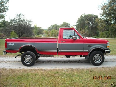

Hey! ...a Mainer! And your truck isn't rust orange and full of holes! What's your secret? :D
don't be fooled lol.i bought it in CT with rusted out fenders (all 4) front bumper,and faded paint.
she got replacement front fenders,bumper and a paint job.
in '09 when i bought it:
