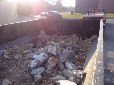

Do you all have those mini roll-off dumpster where you are? I pull a few on occasion and this morning picked one up that had some concrete and dirt in it. I had painted lines on the inside of the can so the guys would know where the over load level was. It was loaded about right. They had it loaded a bit heavy to the front but that happens sometimes and is actually better than being loaded too heavy in the back.
I got it winched up on the trailer, it felt a little heavy but it towed pretty good. The front tires were a little light on traction but just enough to remind me to be cautious.

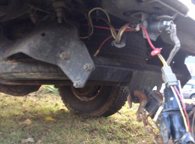

I drove maybe five miles or so to the dump site and just as I stopped prior to pulling onto the scales, the front tires skidded a bit, something went "FLUMP" and made a dragging sound.
Uh Oh, no good.
As it turns out, after traveling five miles through town and a few back roads, the hitch folded up after I reached my destination.

Impressive. Those side plates look awfully thin for that load, probably just a class one or two receiver. I have always thought it was dumb that you can sell a light duty receiver that will accept a 2 inch hitch. I think they should limit the light duty receivers to a 1 inch hitch so this doesn't happen. Most folks think that if it will take a 2 inch hitch its a "heavy duty" receiver.

It happened at the dump site so I drove to the unloading area and emptied the box. With the load off of the trailer, the hitch is now several inches off the ground and doesn't make that horrible scraping noise anymore.
The tongue was heavy enough that I twisted the safety chains one turn to take a little slack out. It really wasn't terrible.

I would bet the frame to hitch bolts were loose and fell out or just plain sheared. That hitch is done for, please don't try to use it again. Always check your equipment before use.

It is a Reese brand hitch. I cannot find a data plate plate on it and neither can I find it in a catalog online that would tell me what it is rated for.

I have done a little head scratching on this before. It seems as you get to a class 3 and higher hitch, it's no longer "dummy proof" as far as things fitting together. Except the class 5 is supposed to have a 2 1/2 x 2 1/2 opening instead of a 2x2. But it looks like to me you could use a class 3 or 4 and not really know the difference as far as things fitting up.
Maybe that hitch you have on the truck above was a class 3 instead of a class 4?

I had a hitch like that one time on my truck. It had the bolt in center bar between the two rails. One day I loaded something and noticed the hitch move independent of the truck. Crawled under there and the horizontal bolts on the hitch were loose. I was glad I caught it and it scared the hell out of me. I replaced that hitch with a higher strength one later.
