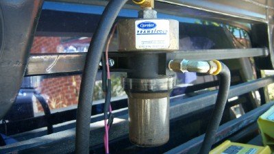

I found this carrier transcold electric pump. The part number is 30-01108-02SV. Its max pressure is 7 lbs. Is this what I want for a good replacement to the holley red... Thanks guys and others...:eek::D

Have you got a picture of it?
I just went out and looked at my 2 duralifts and the latest one I just bought has 30-01108-00 on it, , the other one doesn't have the number on the pump, but that last part does sound familiar from a box I had laying around.
or does it look like this one? If so, that's the critter.
