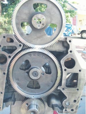

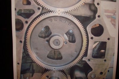

No matter what you "see" on u tube viedos.. Never remove the injection pump with said pump connected to the housing. Doing this will loose your cam gear to injection pump gear timing. Many here can help you "fix it" but.. Its so much easier to remove the injection pump the CORRECT WAY the first time. What happens is when all these parts come off the top of the engine you have no SURE way of seeing the gears line up when you re install it. One tooth off either way is really going to mess up the timing. You can't move the injection pump enough to time it correctly. Hers a pic of the gears lined up correctly.Notice the DOT and the Y marks on the cam gear. You do not want to mix those up. Oddly the engine will run when you make the Y & Dot marks line up but it runs very badly cause its 180 degrees out of time.

Like icanfixall said, just leave the housing and gear on the engine. Changing an injector pump can seem intimidating to someone doing it for the first time, but it's not really that bad. Personally, I'd much rather change an injector pump (on a N/A engine) than the lift pump on the side of it. When you look at other injector pump, you will see three bolt holes and a slot on the part that mates to the gear. That slot needs to be lined up with a dowel pin on the gear. I try to line them up as closely as possible before I try to install the pump. You can use a small screwdriver or pick to reach through the holes in the gear to make final small movements. Also if your pump doesn't want to slide all the way forward into the gear, don't use the three nuts that hold it to the housing to force the pump into place. I've been told that this can damage the pump. If you have the bolts started loosely in the pump, just wiggle the back of the pump up and down and it will slide into place.
The pumps can be tuff to slide into the gear housing because of the o ring. But some wiggleing helps this fit easily. I have a video here somewhere showing the simple easy way of removing the injection pumps. Once the pump is disconnected from the injectors, the gear housing and the gear. you push the pump towards the intake manifold. Move it towards the drivers side a little bit. Then the back end is free of the housing. Then shift the rear end of the pump to the passenger side and lift it up and out between the 2 mounting studs on that side of the housing. The throttle cable bracket must be removed and the fuel feed line from the filter must be removed.. But all the hard lines can stay on the back of the pump.
