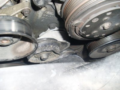

vac pump locked up this morning on my way to the shop.....
no warning from the damn thing either.
what a flippin' mess......-cuss-cuss-cuss-cuss

:eek:EEeewwww, what a mess. Did I see correctly? Did the heat from the belt disfigure the plastic idler pulley? Is there anything in the way of preventative measures I can do to keep that from happening to mine? On my engine the vac pump is down low on the passenger side and will be a pita to get to. Think I should go ahead and just swap it out now, seeing as how I have no idea if it is original or not?

vac pump failures on V-belt setups is not as nasty. you can take out alot of **** on the serp setup.

the vac pump is dead simple to pull off, its 2 bolts and a hose and a belt that have to come off

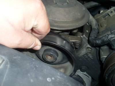

see the burn mark on the inside of the vac pulley? the sucker is no longer round.:mad: ie.....new pulley time if I don't want a harmonic set up so the tensioner assy gets destroyed.-cuss-cuss-cuss

Nice. In the 250 I had the vac pump pulley seperated at the welds, we welded it back together and it was ok. Glad the scouts a V belt with just a one wire alt, and a power steering pump!!

Was there any damage other than the idler pulley and the belt? Did the belt break while on the truck, or did you cut it off in the process of removal? I take it you were able to limp the truck the rest of the way to the shop...

Holy Schnickles batman.... That's gotta be the worst failure I have ever seen. I know when all of mine died (vacuum pumps) they just stopped sucking and turned a light on to warn me that the next time I pressed the brake pedal it was going to be fun....

so far the carnage is at
1 Vac pump
1 vac pump pulley
1 auto tensioner pulley
1 idler pulley
1 belt (approx 2 weeks old :mad:)
