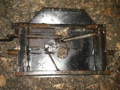

Anybody recognize this 5th wheel hitch manufacturer?

This came with my truck, just trying to figure out who made it so I can get the correct mounting hardware and figure out what the capacity is.

The base doesn't look standard to me. If it came with the truck, but it wasn't mounted, just chuck it. I bought my 16k RBW hitch for $150 used, and spent $25 on the missing pins to hold it to the rails, + $25 on the heavy angle iron/bolts to mount it to the frame. I would say far easier than tracking down rails for a non-standard hitch that is out of date.

Looking at the pictures, Towcat, I have doubts that the square connectors are shallow enough to mount to the reese rails. My RBW uses the same type of rail and they are NOT tall at all.
Maybe we could get a closeup side view of the hitch/rail connector OP?

Yup.....old Super5th it will work fine if you can get the parts to make it fit some rails....Just make sure the latch works good....

Thanks for all the input. This was mounted in my truck at some point, but it was taken out and of course, the fasteners were misplaced.
Thanks again for all the help, I am going to try to get an installation manual and get the correct hardware to get this back into my rig.
