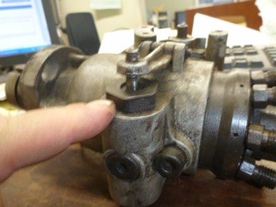

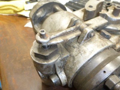

Here's the broken bit. I don't know enough about these trucks to make heads or tails of it.
He can't get the linkage parts off the pump to replace just those and suggests a new pump since damaging this one would make it unusable as a core.
Tim.
1,442
the broken part is not the issue. in the background the exploded pump advance plunger is the core of the problem. you pump has committed suicide. it's time for a new pump.

Thanks for the pics of the pump. I see what is going on now.
How would the advance plunger get spit out of the pump? Supposedly this pump is less than 2 years old. And I assume you can't just reassemble it...

In all honesty I would haul it home and fix it yourself. As towcat posted.. That pump is shot the *** out the sides of it.. Sad thing too because it was something that could have been solved with a little maintance and oil. So another pump is around $500.00 for a QYUALITY PUMP... Sure you can get ebay pumps for the $350.00 range but know this... You very much get what you pay for on ebay... Some of those sellers are some bad suckers. Please read about a few of them in the Hall of Shame forum.. Installing a pump on that engine is easy but not ever doing one can be a tuff job but we are here ready to walk you thru it.. Really only a few bolts, nuts and fuel lines. Then it lifts out easy with the hard lines still on it.
