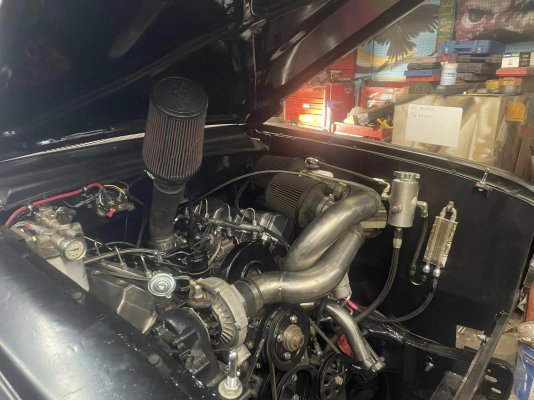

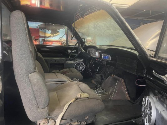

slowly but surely getting there.
i had to order some new turbo oil feed lines, i didnt like the ones i had.
next week itll fire up!

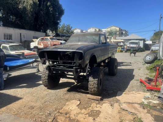

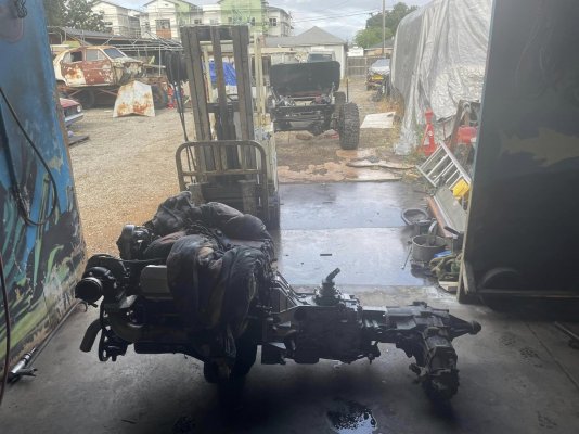

im pulling the engine, but in order to do that, i gotta pull the cab.
its a feces show around here
13,438
4,186

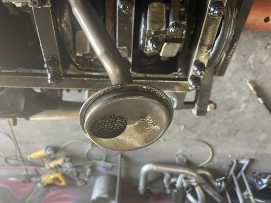

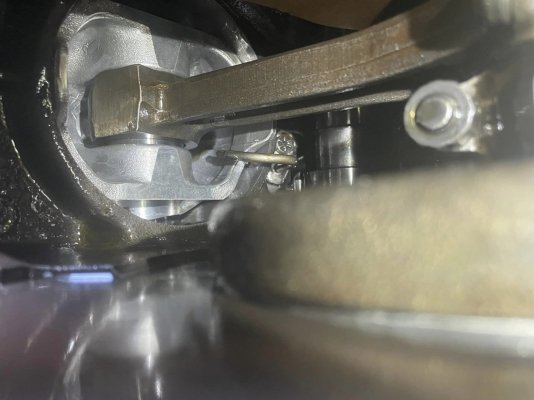

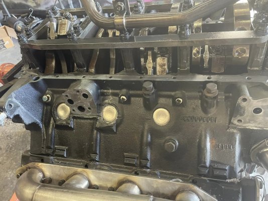

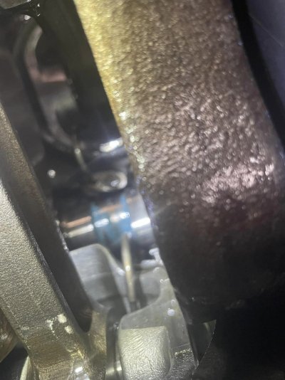

well hell. nothing looks out of place here but the pick up.
but i dont see that as the issue.
oil filter was completely full.
oil cooler was empty.
gotta be the bypass valve
