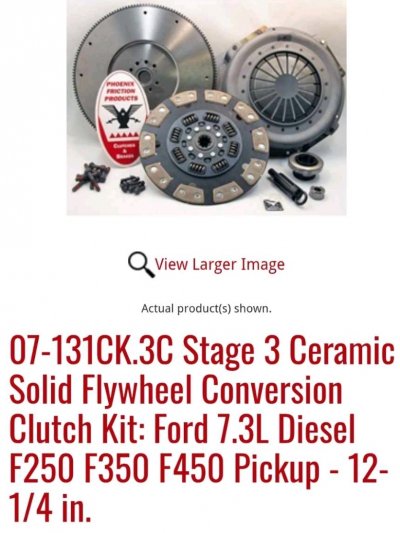

I plan on getting this Stage 3 ceramic setup
