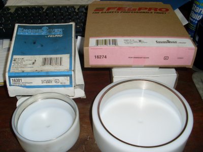

It all boils down to the design. the bottom end on a Cummins is overbuilt in comparison to the ID which is built pretty stout already.
lookie at the pic. this is a comparison between a IDI rear main speedi-sleeve(left) and a Cummins rear main speedi-sleeve(right).

guess im not seeing it but i dont see how a rear mail seal has anything to do with getting power out of an engine? or maybe i was taught wrong but what i was taught was an engine is nothing more then an air pump, the more air you can pump in and out, the more power you can get. guess i can go to them and tell them there wrong, cause its the size of the rear main oil seal, not the fuel/air/heads/compression/ect.

I think you totaly missed Towcats point. While I do agree rear mains have nothing to do with performance potential of an engine, Towcat just happend to have both seals around and used it as an example of one of the ways a 6BT is overbuilt for a pickup truck aplication. You can put more power down out of a cummins much more reliably with out upgrading the bottom end than with a PSD or duramax. Cummins designed the engine to be used in higher HP aplications than the pickup whear as the duramax was designed for a pickup and the 7.3 and 6.0 were designed half for a pickup and half for a low HP requirement medium duty trucks the HP numbers of the IDI and the 6.0, Not sure about the 7.3 psd are actualy lower in a international than in a ford.

you're partially missing the point. if all your goal is the max in getting air in and out, then throw out the IH 6.9/7.3 and the 6BT. they're overweight. after all, with your line of thought, a GM 6.2/6.5 will EASILY fill your needs. I've built enough of these motors where they can get stupid fast quick. if longevity is no concern to you, a GM will do everything you want compared to the other two. Now if you want a healthy dose of reliability added into your air pump, you will need to take a look at how the bottom end of a engine is designed and spec'd. an inline with large bearing surfaces will take more power thrown at it and stay together longer compared to a V-designed engine. take away the overkill lower block reinforcements and webbing, you now have a hand grenade known as a GM 6.2/6.5. Fast. stupid fast. But don't ask it to work hard. It will tear out its 2,3,&4 main webs and toss the crank out the pan too.
if you can visualize the bearing size differences by the speedi-sleeve comparo, you just understood my point in posting the pic. if not, just carry on. the point of all this was a simple visualization exercise. nothing more.
