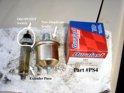

Thanks all, got everything resolved. Found out how to convert the oil pressure "idiot" gauge to an ACTUAL measuring guage via a new sender unit from an older year Ford (http://www.rowand.net/Shop/Tech/FordOilPressureGaugeFix.htm) and the removal of a 20ohm resistor.
Found the part at Autozone for $10 bucks, removed the 20ohm resistor and restored the old guage it to it's originally designed purpose - to measure oil pressure! Also put new teflon tape on all the threads and now have NO LEAK with a REAL GAUGE to boot. Happy as a clam.

I went for that in the summer, I was on it like white on rice when I found out it can be fixed like that... Then I also found out my gauges cluster won't come off cause my darn speedometer cable won't let it slide out enough to where I can get a hand in here and unclip it...

Ahh, well I was VERY lucky then, cause my 20ohm resister was simply plugged onto the end of the original plug at the sender. All I had to do was unplug the resistor (about 3 inches of line) and plug in the remaining line. Too easy.
